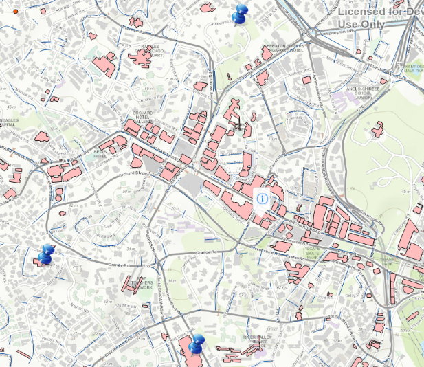

Even when I tap on a place where I did not put a pushpin, it still shows up an empty callout dialog:
I found that the AGSFeatureLayer has implement AGSLayerCalloutDelegate, maybe it's the reason to show an empty callout when user tap on that AGSFeatureLayer?
