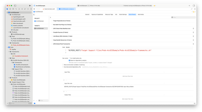

I downloaded your project, and run `pod install --repo-update` before opened the `ArcGISSample.xcworkspace` file. Then I added a map view to the project, and it builds and runs.
Attached is a screenshot of the project. Can you find anything helpful to you?
I'm also using CocoaPods version 1.11.3. I changed your project file format to Xcode 13.0-compatible and also lowered the target to iOS 14.0, in order to verify ArcGIS 100.15.0 still works on older version. All seems to be fine for me. 🤔
