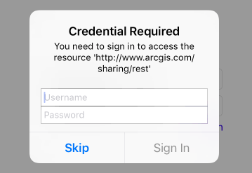

Dear All,
i'm using the code present in the ArcGIS Runtime SDK for iOS (Quartz Beta) to connect to the portal:
var portal:AGSPortal!
self.portal = AGSPortal(URL: NSURL(string: "http://www.arcgis.com")!, loginRequired: false)
self.portal.credential = AGSCredential(user: "username", password: "password")
self.portal.loadWithCompletion() {[weak self] (error) in
if error == nil {
  // check the portal item loaded and print the modified date
  if self?.portal.loadStatus == AGSLoadStatus.Loaded {
   let user = self?.portal.user
   print(user?.fullName)
if i inserts wrong credential, the system shows ever a default popup to insert the credential (see attachment):
Is possible to manage the login error with a custom code?
In the previous SDK was present a portal delegate "didFailToLoadWithError" to manage the error.
In the code present in the example about Quartz SDK, seems that the code "if error..." is not execute because the systems shows the popup attached.
Is possible to hide the default popup how the previous SDK and manage all errors by code?
Thanks in advance!
Tony

AntonioFiume
Deactivated User
Really really thanks!!
It would be impossible for me to found this way!
When i inserts the didReceiveAuthenticationChallenge the default login message now is disappear
Please note that i inserts the  challenge.cancel() code in the function to work fine more time usert tried to login with wrong credential:
func authenticationManager(_ authenticationManager: AGSAuthenticationManager,   didReceive challenge: AGSAuthenticationChallenge) {
       //Important to work fine when retry to login more time
        challenge.cancel();
Really thanks again Yue!
