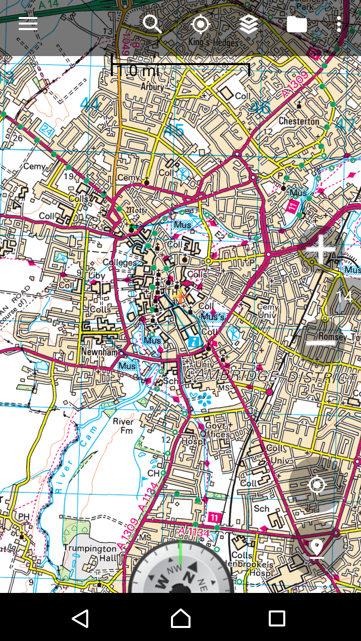

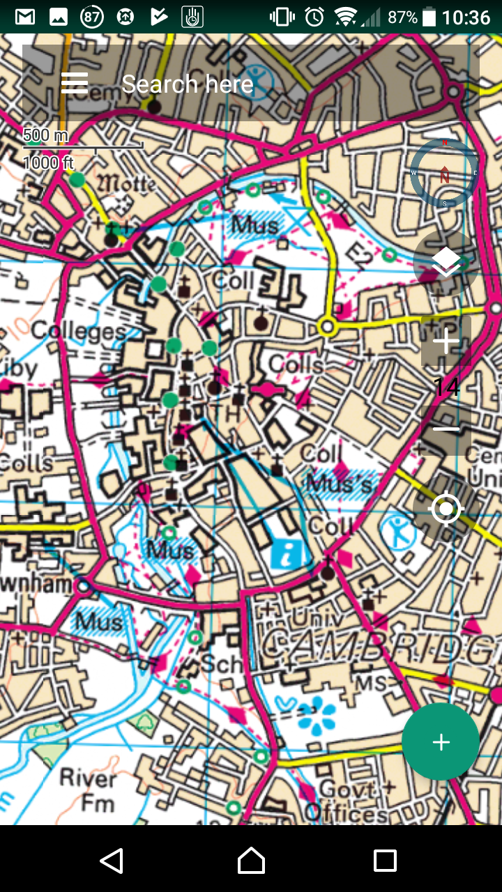

So far so good, but take a look at these that a user sent me.
Other code rendering tiled map.ArcgisMapView rendering
On the left is a custom map view invented in house. On the right, one using ArcGIS Android SDK.
Both of them say 14, but it has a different meaning.
On the left, it is a one to one pixel ratio. 14 means LOD 14 of the tile server.
On the right, 14 actually means Scale of 1:36111.909643.
But you must be taking into account the dpi of 96 vs whatever the screen dpi is.
