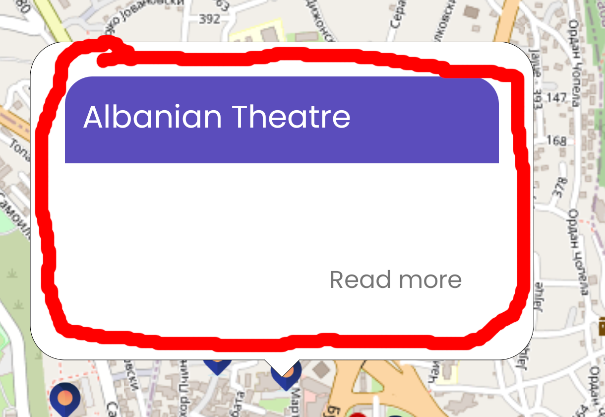

Hello esri community,
I'm trying to show a callout that needs to be in the same callout window except without the extra white space that I've marked with red.
My implementation is the following

No matter what I do there's always extra white space around the view.
Any help?
AlanLucas
Hi Hristijan,
The Callout includes padding equal to the Corner Radius. Reducing the Corner Radius will reduce the empty space.
Hope that helps, Alan
HristijanPetrovski
The design requirement has a cornered radius but i don't need the extra space.
HristijanPetrovski
If i reduce the corner radius to 0 and my view is rounded, the edges that are sharp (not rounded) will be visible since they're drawn behind my custom content layout...
