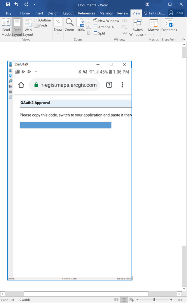

I am trying to update our application to 100.5 from 10.2.9.  I am trying to authenticate the application and have an application setup for the application in our AGOL Organization with a client id and redirect uri.  Am running into issues using OAuthLoginManager when I run oAuthLoginManager.launchOAuthBrowserPage(context); I get the message...
Please copy this code, switch to your application and paste it there.  Struggling to find a good example that describes this.  Also strange that it opens up Chrome rather than opening within the app as it did with 10.2.9.  Any guidance in the right direction greatly appreciated.

Gunther, OK am back to the same issue as with the other method.  Get this after I login with AGOL credentials.  Tried several organizations I have membership to, but got the same results every time.
