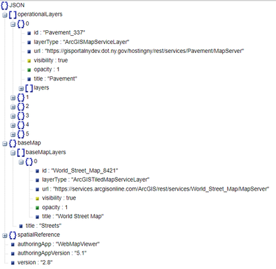

I have json file with basemap and all operational_layers, unable to load on arcGIS mapview.
Nicholas-Furness
The Map View is used to display an ArcGISMap. It is not itself a map. See this introductory documentation.
But since this is a web map that is hosted, just open the web map by creating a portal item that refers to the item you got the JSON from. There's no need to retrieve and work with that JSON yourself.
See this tutorial: https://developers.arcgis.com/android/maps-2d/tutorials/display-a-web-map/
If you really need to open the JSON, create an ArcGISMap from the JSON. Display that in the map view.
