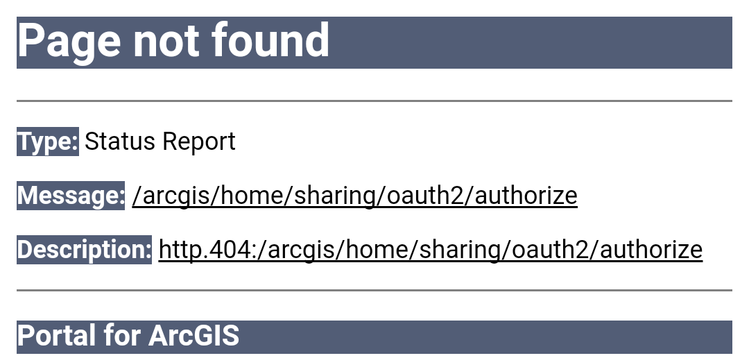

I'm having a trouble when I try to authenticate (via Android) in the ArcGIS Portal.
I've changed the ArcGIS Portal default directory. Switched "MY_PORTAL_URL/arcgis/home" to "MY_PORTAL_URL/portal/home/". But when I try to access the ArcGIS Portal (using com.esri.android.oauth.OAuthView) to auth the user, its returns the page below:
How can I solve this issue? Any ideas?
Thanks

Hi,
Try to use only "MY_PORTAL_URL/portal". Remember to register your application with Portal: How To: Add Collector for ArcGIS (Windows) as a registered application to Portal for ArcGIS 10.3.1 (In step 16, change the App ID to your Application Client ID).
