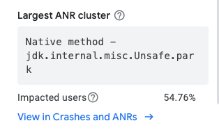

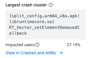

Device info as in? All I get from the Google crash report is (as far as I can see)
Sample attributes:
samsung dm2q (Galaxy S23+)
Android 14 (SDK 34)
Edit: I don't believe the impacted users percentage shown above from the Google Play Console to be correct. We have 38k active installs of the app on Android and perhaps ~200 affected users.
These are our top reported crashes, and if I show the details for each, they all mention RT_Vector_setElementRemovedCallback just with slight variations.
