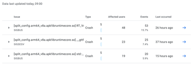

I am seeing an increase in crashes with this stack trace (from Google crash details).
This is running runtime version 100.15.1. According to Google it happens on Android 11-14.

I haven't been able to reproduce it myself, and I'm a bit empty on ideas. Does anyone here perhaps recognise what this could be related to, or maybe it's something you have seen before? From the stack trace I can't find which part of my code that triggers this either.

These are our top crashes so quite annoying.
