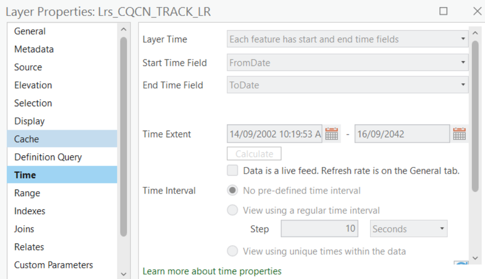

I had expected to fix these layers by simply changing their data source to the new feature service.  First I just added that feature service to my map to make sure that the Layer Properties had the correct time properties  and they did:

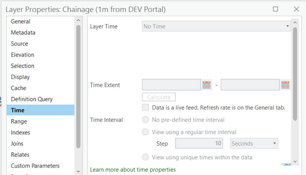

then I tried switching the data source of a layer with complex symbology to the time enabled feature service but the Time tab of its Layer Properties did not get those time properties:
