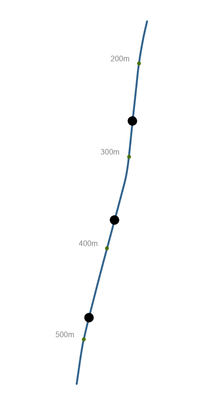

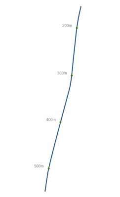

In the picture below I show one LRS route with hatch markers and text at 100m intervals.  The start measure for the route is 154m and the end measure is 548m so I see text at the hatches for 200, 300, 400 and 500m.
I want to be able to create point features at those hatch locations.  If I use the Generate Points Along Lines (Data Management) tool with these parameters:
arcpy.management.GeneratePointsAlongLines(input_LRS_network, output_points, "DISTANCE", "100 Meters", None, None)
I get points located as below which makes sense because there is no parameter that lets me specify that I only want points at the round number interval measures.
