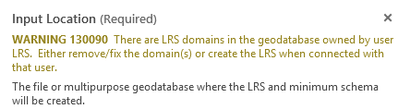

I'm trying to create an LRS using ArcGIS Pro 2.6.2 into an sde database which has already another LRS created by other user. I get the error attached.
Is it mandatory to create all LRS's with the same user?

When you create an LRS there are several domains added to the geodatabase specific to Location Referencing (dActivityType, dLRSNetworks, dReferentMethod). If you are using a database user other than the user that originally created those domains you'll need to either remove the domains or create the LRS when connected with the originating user. Our Create LRS GP tool should have notified you of this requirement:

Amit is correct that you won't be able to create a second LRS if the first one was created by a different user.  I'll also mention that whoever is going to be the data owner for the geodatabase should be the user that creates the LRS as that user will need to be connected when publishing LRS enabled services.
Is there a reason you'd like to create a second LRS in the geodatabase?  Typically users create multiple LRS Networks, but have a single LRS in their geodatabase.
