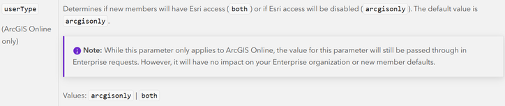

Katie_Clark
MVP Alum
This post helped me a lot and so I wanted to add to it, with a link to specific Esri documentation. It basically says the same thing in the GeoJobe link, but also provides other information that might be useful for other user properties:
userType determines if new members will have Esri access (both) or if Esri access will be disabled (arcgisonly). The default value is arcgisonly.
ArcGIS REST API
https://developers.arcgis.com/rest/users-groups-and-items/set-user-default-settings/
ArcGIS API for Python (arcgis.gis.User.user_types)
https://developers.arcgis.com/python/latest/api-reference/arcgis.gis.toc.html#arcgis.gis.User.user_t...
For me, what I really needed was the userLicenseType value from the REST API, which is what you get with the User.user_types()["id"] call mentioned by @RHmapping
