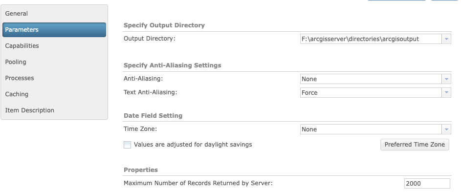

Ok open server manager and find the service. Click the pencil.
On the parameters tab there is a setting called "Maximum Number of Records Returned by Server"
Change this to a bigger number but remember that this will make queries slower - eg if you for example make the maximum 20,000 records.
