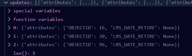

This is the updates object, as displayed in a debug session:
The error I receive when sending this object:

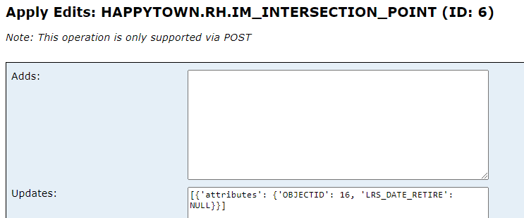

I can successfully update the field manually using the ApplyEdits endpoint with this object:
But I am not able to set this value to NULL through Python, since Python uses None as the NULL keyword and will not recognize the value of NULL.

Are you converting to JSON before sending? What does the JSON representation of your updates object looks like? The REST endpoints only accept JSON and None is not valid in JSON, it needs to be null.
AdamStevens81
Thank you, this did the trick!
I just needed to use json.dumps(updates_object) to create the JSON representation, and this was successfully passed into the applyEdits endpoint.
