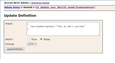

I have just tested this in a test Enterprise Portal 11.2:
and the response was:

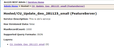

When I check the page again:
The Service Description now shows the new value.
Give that a go and see if it works for you.
