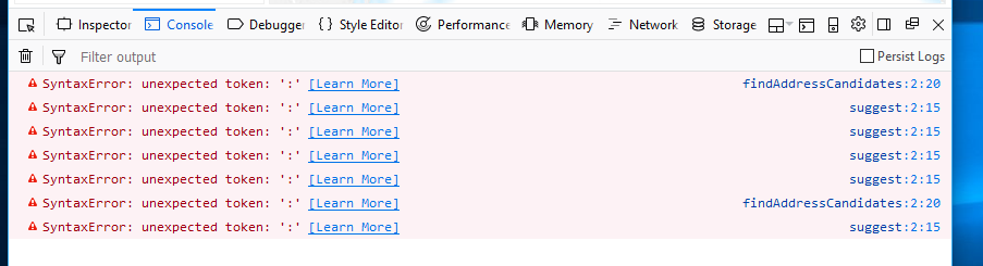

In the Portal map viewer, I've selected the custom GeocodeServer from the Find dropdown list, and enter some text. No suggestions are shown, and, when I press Enter, no candidates are found.
Looking at the console reveals a SyntaxError for both the suggest and findAddressCandidates requests:

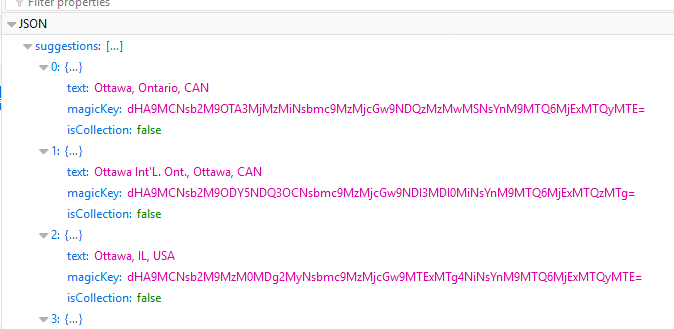

Looking at the response from the custom GeocodeServer for a call to suggest:
it appears to have the same syntax as the response from the ArcGIS World Geocoding Service:
The same is true for calls to the findAddressCandidates method. For the custom GeocodeServer:
and for the ArcGIS World Geocoding Service:

It turns out that there's an "undocumented" "feature" at work here with the REST API. In addition to the documented parameters, there's a `callback` parameter; if the client provides a value for this (which Portal for ArcGIS does), then the service needs to wrap the response in the provided callback. Once I did this, then it worked correctly.
