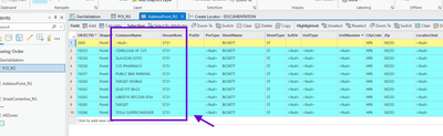

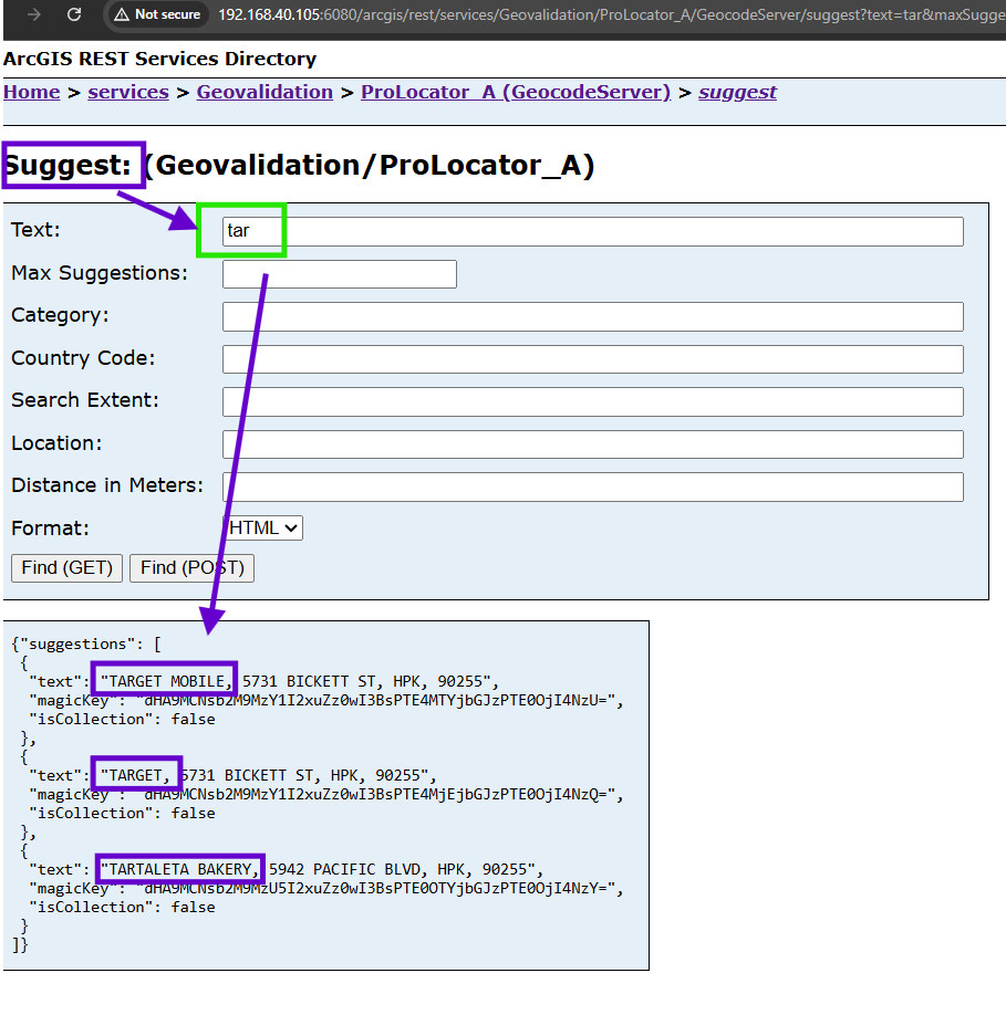

when i search "target" it suggest return correctly with all common name + address.
see here

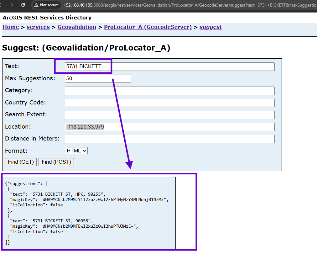

when I search address,  "5731 bickett st", it should show target, however, suggest only show address, missing common name "target"

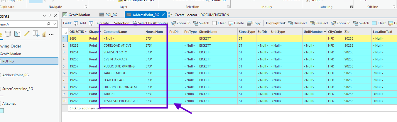

This 5731 actually has 10 stores, I want suggest to show all 10 stores with same address,
However, suggest show 0 store, only show 1 address. which is wrong.
hoogw
find address candidate should show all 10 stores with same address 5731 bickett ave,
however, it only return 1 candidate without offCommonName.
