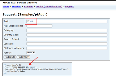

if just search number, 5731, without any letter, it failed.
It should list all the address start with 5731.
if search 5731 with at least 1 letter, suggest api works fine.

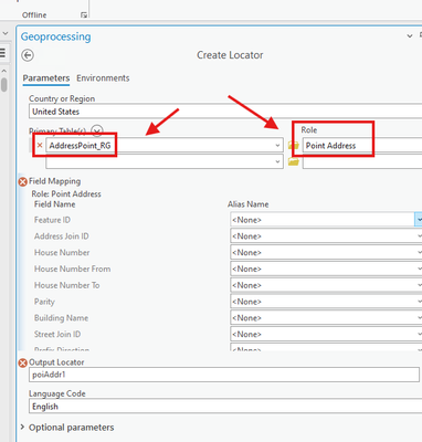

This locator is simples use addres layer as POINT ADDRESS role
