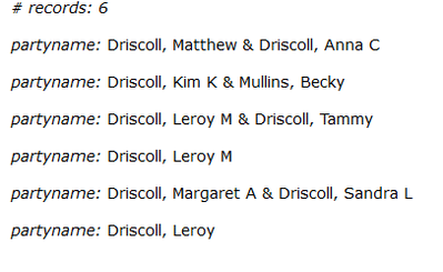

But a very simply expression does not work.  PartyName LIKE '%driscoll%',
on this layer: https://www.jfksgis.us/server/rest/services/Hosted/Parcel_hosted/FeatureServer/0/
The SQL query works fine in Pro and for Online services: https://services1.arcgis.com/tpr1e2h7Rmn9C5oc/ArcGIS/rest/services/JFKS_GIS_ParcelOrion_Public_V4/Fe...
So is this not actually supported in server 10.9?

Seems to work just fine, but keep in mind that these queries are two different things:
PartyName LIKE '%Driscoll%'
Unfortunately, we can't use ILIKE to ignore the case of the input string. Using a bracketed set of characters, like "[Dd]riscoll" doesn't appear to work here either. I guess you'd have to combine two queries and put an OR between them.

Thanks.  This is a simplified problem, I have many attributes I need to query.  ESRI is logging it as an enhancement instead of a bug, even though it is a basic very simple sql statement, so it might be a long time until it gets fixed.  They need to update their documentation that  supportsOutFieldSQLExpression is not supported currently with rest endpoints.
