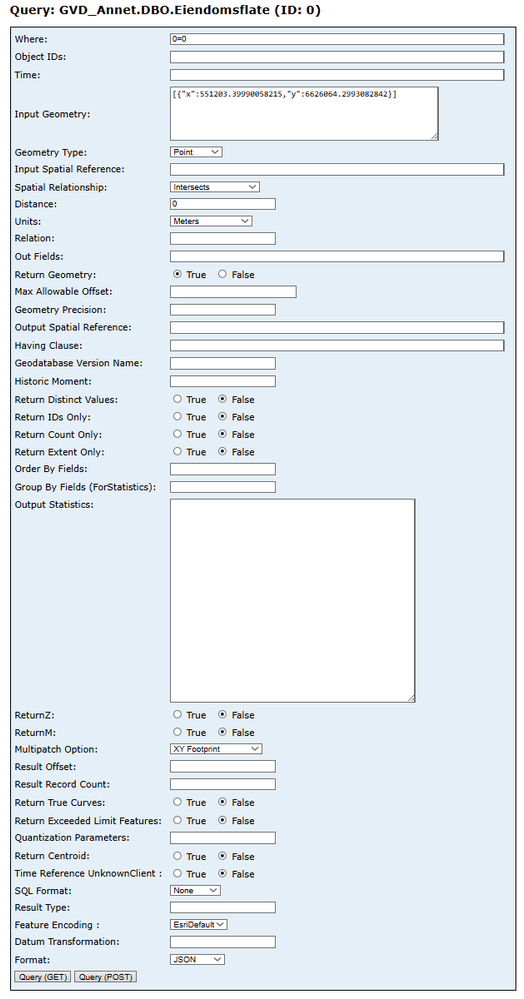

I'm trying to query only the polygons that intersect with a given point feature, but I'm getting all the polygons in the layer.
This is my querry
Neal_t_k
MVP Regular Contributor
Try taking out your square brackets,  adding the wkid of your coordinates in the "Input spatial reference" , and leave the "distance" blank.
Neal_t_k
René_AstadDupont
Removing the distanse, was the varaint I had not tetstet.
Thenk you.
