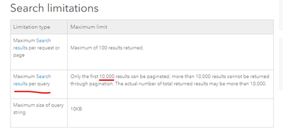

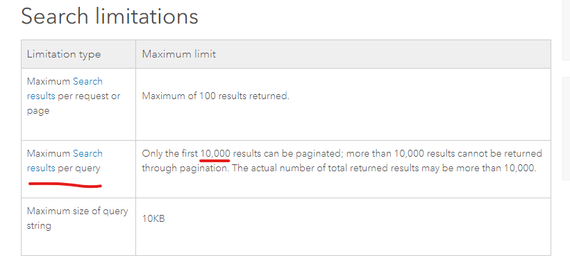

Some links (below) back the findings I am referring to:
https://developers.arcgis.com/rest/users-groups-and-items/considerations-and-limitations.htm
