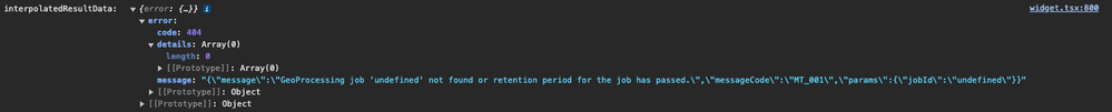

This is part of my implementation. I am skipping the rest because the code runs fine when I either don't specify the boundingPolygonLayer or when I use the url. When I use the germanyDict I get the following error from the submitted job
Any help would be greatly appreciated.
