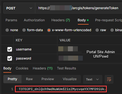

I'm struggling with getting a non Portal site admin user account to be able to generate a token?
Using Postman if I generate a POST call with the username and password of the Portal Site Admin in the body to: https://<URL>/arcgis/tokens/generateToken I get a valid token back:

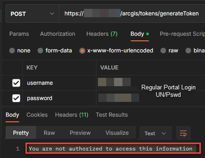

If I do this exact same call with a different user it reports back:
You are not authorized to access this information

@WarrenMedernach I believe @shahkunal was correct. You appear to be requesting a token from the ArcGIS Server end point. If your ArcGIS Server is federated you will need to generate a token from the Portal end point. This will be valid for the ArcGIS Server once generated.
Remember, a federated ArcGIS Server doesnt know anything about any users except the admin user it was configured with - hence the error.
