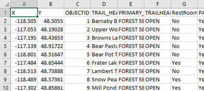

I downloaded it and it gave me exactly what I was looking for (yay!). However instead of giving me latitude and longitude it gave me arcgis X and Y values.

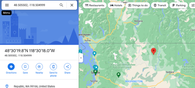

I've just downloaded a csv from the open data site you linked and despite the fields being labelled x/y those are latitudes and longitudes (x=longitude, y=latitude).
And in the reverse geocode example you posted the results are in WGS84 (WKID4326) which is latitude and longitude. You can plug them into google maps and it will work, I've done this with the top row of the csv below

Thanks so much. I was interpreting it as X = latitude and Y and longitude and it was not working for me. Yes what you say totally makes sense.
