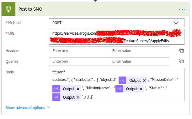

I have set up a Microsoft flow to trigger when rows in my Smartsheet are updated. I followed this tutorial on how to update values using the ArcGIS REST API. Everything works as it should using Postman. I noticed however that the ArcGIS Rest API is expecting multipart/form-data including key value pairs for f:json, a valid token, and then the updates. Postman handles this natively by selecting the form/data option for the body and automatically creates boundaries. MS flow apparently does not handle multipart/form-data natively. How do I structure my body to pass a valid POST request to the API to update my feature service? Screenshot of MS Flow HTTP Post below. Also below is the successful POST from Postman using the exact same data. I should note that this feature service is shared with editing enabled, which explains my missing token key value pair.

All, I finally got this working and I want to share the solution and some things I have learned about MS Flow and testing the ArcGIS REST API using Postman. Maybe you seasoned programmers know this stuff, but I sure didn't. Ultimately, and most importantly it is possible to use the MS Flow HTTP trigger with the ArcGIS REST API to edit features, but it is a little tricky. The most annoying thing I found (and I'm not sure if MS Flow is at fault or the ArcGIS REST API) is almost always the response from the API will be 200 (Success), even though it is not successful. Below is a malformed request, but you can see we get a 200 back. It should respond back as a 400:
For awhile, I thought that my Flow was working properly, until I realized my features were not updating. Lesson learned, do not trust or rely upon feedback from MS flow. This little green box is deceptive.
I also learned some valuable info about Postman. I assumed that pasting in the raw sent request from the Postman Console into the body of the Flow HTTP trigger would work. (Because hey, the request works great in Postman - everything updated as it should). But even in "raw" mode, the console doesn't actually show the true request that was sent to the API. However, the "Generate Code Snippet" tool in HTTP mode does. This ultimately helped me figure out what to paste into the header and body portion of Flow.
Ultimately, pictured below is how you would format your header and body (configure your token for authentication under the "Show advanced options" at the bottom) to successfully POST to a feature using the ArcGIS REST API to update attribute features. The main trick is defining your boundary (unique string of characters which separates your different forms in the body) in the header (in my case I just used what Postman auto-generated, but it could be anything). I hope this saves you some time if you want to use MS Flow and the ArcGIS Rest API.

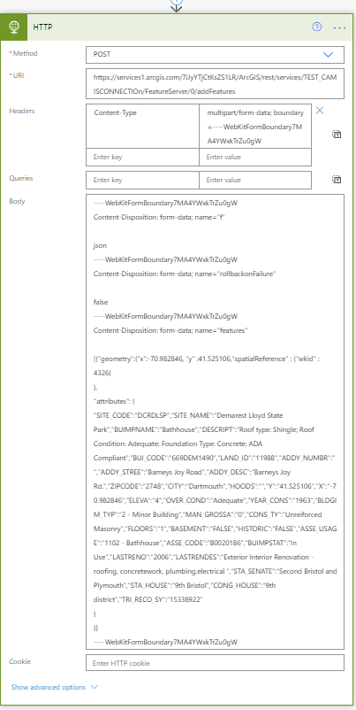

Such a helpful post, learned how to looks at how Postman structures the request.  I was wondering if your were still having success with this method.  I has success posting using Postman but when I try to structure the POST request using the code from Postman, I am getting the 200 code response but the data is not being pushed to the hosted feature layer.  I have shared the layer publicly in order to avoid dealing with the token for now.   Any ideas? Or suggestion? Would be deeply grateful!
COSPNWGuy
Hi @FranciscoRodriguez2,
Sorry for the delay. I still use MS Flow (Power Automate now) a lot and create and update features, though I no longer use Smartsheets. We use Monday.com now. And this method still works. Your screenshot is really hard for me to make out. One trick is to open up your console and look at exactly what postman is sending to the API. This might help you shake it lose.
