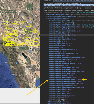

hoogw
In 2025, I confirmed that only FeatureServer( feature service ) have returnCentroid.
Any arcgis online ( esri hosted ) have this, because esri hosted only provide featureServer(feature service), esri don't provide hosted map-server(or map-service).
You have to host yourself for a map-server(map-service)
here is sample
https://services.arcgis.com/aA3snZwJfFkVyDuP/ArcGIS/rest/services/BDC_Cities_and_Communities/Feature...

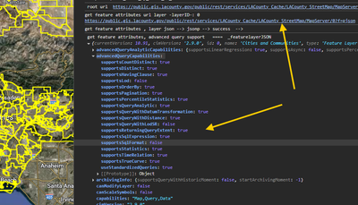

While MapServer ( map service ) don't have returnCentroid.
here is sample
https://public.gis.lacounty.gov/public/rest/services/LACounty_Cache/LACounty_StreetMap/MapServer/0?f...
