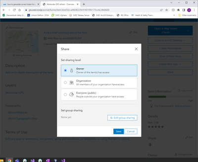

This sounds like a permissions error regarding sharing those layers in the ArcGIS Portal.  Connect to the Portal as an admin or someone that has control over the Content.  Select Content (usually across the top of the web page), then select the Feature Service or Web Map in question and check the Share permissions.

Hi @ZachBray thanks for responding. This is really my first time working with Enterprise closely, and I myself don't personally have access to the system, so I'm just trying to understand how this is all supposed to work. I believe they've already configured authentication on the "registered" layer coming from this other server, but I am not very familiar with the mechanics.
