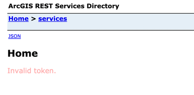

I'm trying to access admin APIs for my feature service, but I'm unable to get a valid token. I saw this post and followed along (https://community.esri.com/t5/arcgis-rest-api-questions/generating-token-for-arcgis-online-hosted-se...) and I was able to generate a token. However, when I add that token into my URL to access the admin services, it says Invalid Token. Is there another way I should be generating this token to get the access I need?
URL to generate token looks like this:
https://www.arcgis.com/sharing/generateToken?f=json&username=USERNAME&password=PASSWORD&client=requestip
URL to try to access the feature service admin APIs looks like this:
https://services6.arcgis.com/qDx.../arcgis/rest/admin/services/Layer_Name/FeatureServer?token=2nt...
Error:
