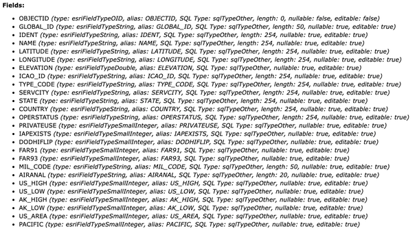

Hi @JAARSSoftwareDevelopment ,
You are right, the "fields" property describes the columns of that table, apparently there is no "clt" field:
You can also check the layer description like this: https://services6.arcgis.com/ssFJjBXIUyZDrSYZ/arcgis/rest/services/US_Airport/FeatureServer/0?f=json
This is how it looks:
2022-05-31_08-06-46.png2022-05-31_08-06-46.png 2022-05-31_08-08-00.png2022-05-31_08-08-00.png
The first image is the response in .../FeatureServer/0/query?.... The second one is from .../FeatureServer/0?f=json.
