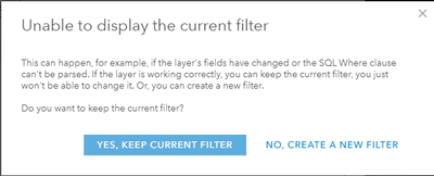

I was testing the link by adding it to a web map. Got a message that said "unable to display filter" but I think it's because it's a GeoJSON URL. The feature showed up fine in the map. I think it's working fine, that just confused me. Thank you for your help!
