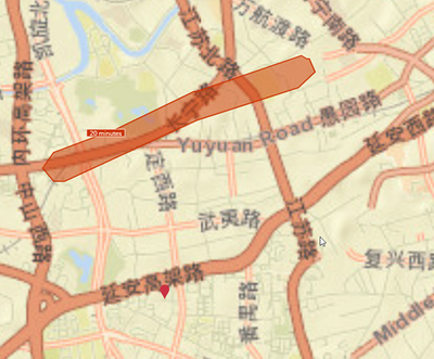

You may be better off creating 1-mile rings instead 20 minute walk times in any case due to minimal routing data coverage in China. For example, if I drop a random point in Shanghai and try to create a 20 minute walk time, the results are very poor and in some cases the area doesn't even snap to the point.
