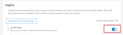

In Portal > Organization > Settings > Security, do you have ArcGIS Logins disabled:
