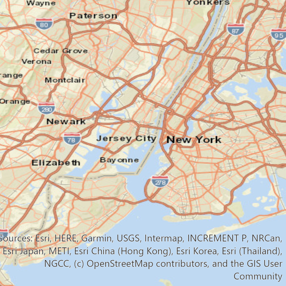

}Using a MapServer works, but again it's unstyled:
I tried to use the VectorTileServer instead, replacing it with:
"url": "https://basemaps-api.arcgis.com/arcgis/rest/services/OpenStreetMap_v2/VectorTileServer"But that gives me an error instead. Adding the token to the url, or as an added parameter, did not help.
Omitting the operational layers completely led to a white image instead.
Is there a way to export a styled image of a given map region?
