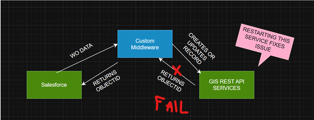

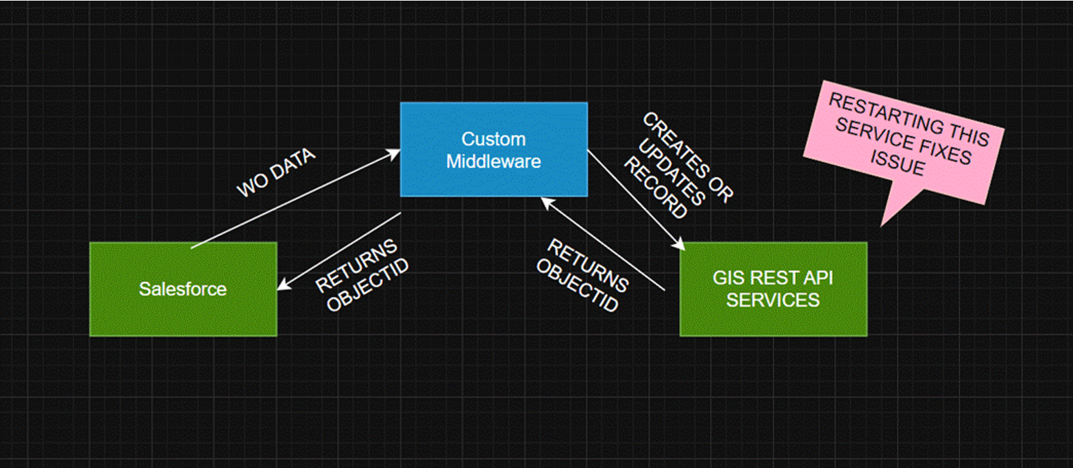

We are using Salesforce to create a work order. Then
  • AWS middleware is used to take that Salesforce data and,
  • using a feature service that references a SQL SDE feature class,
  • create a geometric feature populated with Salesforce data.
  • Either a line or point is created.
  • The geometric feature in SQL SDE is being used on a version.
Here's where we have a problem. We automate reconcile/post/compress daily at 2am. We have found that if we do not restart the REST services being written to by Salesforce/Middleware, that the Middleware request to create a feature in SDE via API, is failing.
Once the REST services are restarted, feature creation by the Middleware works again.
We are running
  • ArcGIS Enterprise 11.5,
  • SQL Server 2019.
  • Our SDE databases are traditional versioning (not branch versioning).
  • No Geometric network is involved.

CathyAlmberg
Thank you for your feedback Venkat. We have adjusted the REST service restarts to occur after the rec/post/compress, and this seems to do the trick.
