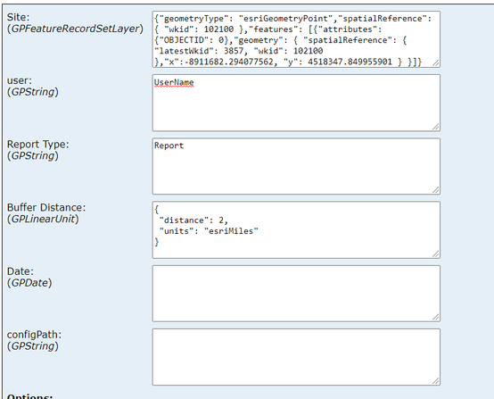

This is what the GP Tool is expecting...I think this is just down to syntax on my inputParam variable?
Am I even doing this correctly...Basically the GP Tool accepts these parameters and then sends back a JSON file.  I want to capture this JSON file and simply show the text in the app for starters.

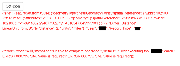

I am launching this from a button and when I do this is the "inputParam" to text....
This is the error I am getting after the call is attempted...
Do I have to create seperate Params for the GP Tool as seen in the the image earlier from ArcGIS Server
        protected void btnGpTool_Click(object sender, EventArgs e)
            string gpUrl = "https://xxxx/arcgis/rest/services/xxx/GP/GPServer/Search";
            string requestUrl = gpUrl + "/execute";
            //make sure requestUrl end with execute **
            HttpWebRequest request = (HttpWebRequest)WebRequest.Create(new Uri(requestUrl));
            request.KeepAlive = true;
            request.Method = "POST";
            request.AllowAutoRedirect = true;
            request.CookieContainer = new System.Net.CookieContainer();
            request.ContentType = "application/x-www-form-urlencoded";// my mistake should be form
            StringBuilder paramString = new StringBuilder();
            string inputParam = @"{""site"": FeatureSet.fromJSON(
              {""geometryType"": ""esriGeometryPoint"",""spatialReference"": {""wkid"": 102100 },""features"":
               [{""attributes"": {""OBJECTID"": 0},""geometry"": {""spatialReference"": {""latestWkid"": 3857, ""wkid"": 102100 },
               ""x"":-8911682.294077562, ""y"": 4518347.849955901 } }]}
                ""Buffer_Distance"": LinearUnit.fromJSON({""distance"": 2,
                ""units"": ""miles""}),""user"": ""username"",""Report_Type"": ""reporttype""}";
            GPToolParams.Text = inputParam;
            paramString.Append($"request=" + inputParam);
            paramString.Append($"&f=json");
            byte[] data = Encoding.ASCII.GetBytes(paramString.ToString());
            request.ContentLength = data.Length;
            Stream requestStream = request.GetRequestStream();
            requestStream.Write(data, 0, data.Length);
            requestStream.Close();
            HttpWebResponse response = (HttpWebResponse)request.GetResponse();
            string responseStr = getStringFromWebResponse(response);
            Response.Write(responseStr);
            GPTooltext.Text = responseStr;
