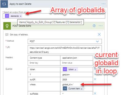

PhilLarkin1
I was experiencing the same problem: query would return geometry but not attributes. I used the wrong parameter name for Out Fields.
Sounds like others have had similar issues with string formatting and parameter names. Be sure to doublecheck that your parameter names are correct! API doc: https://developers.arcgis.com/rest/services-reference/enterprise/query-map-service-layer-.htm

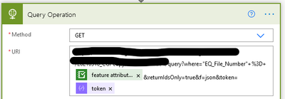

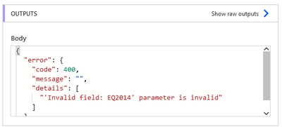

I am running into an issue here and think it has to do with the way my data is formatted...ultimately, I get the error:
For my query parameter, I am using a field that has data formatted in the following way - EQ1234-012
Each time I test my Flow, it gets to the Parse JSON for the query and returns this:
You can see that the returned value is truncated before the "-012" portion of the attribute value. Because of this, there is no match/no ObjectID to return in my apply to each array. I am not sure how to format the Query to properly return the entire value. I have tried a few iterations...
  1. Recommended setup via this blog (screen capture below).
  2. Replace the +%3D+ with =
  3. Surround EQ_File_Number with single quote
  4. Surround EQ_File_Number with double quotes
Here is what my query currently looks like.

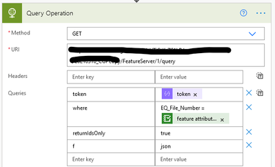

PhilLarkin1
I'd start with option 2. Power Automate is going to handle html encoding for you. Check your result. Does the URI Input look correct; Is the equal sign displayed or do you still have the encoded value (%3D)?
Check URI of HTTP REST:
You could also try removing the where parameter from the URI and placing it in the Query body. Here is an example of a HTTP Rest call in an Apply to each loop

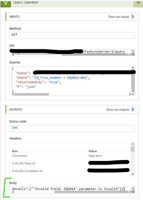

erica_poisson
Hi @PhilLarkin1
So the URI rest url wasn't correct - it still contained the encoding (%3D). I replaced that with a '=' but still got the error.
I then decided to take your advice and format the HTTP GET query using the Query body. I did not do this to my "updateFeatures" HTTP request inside of my apply to each loop. Is this where you thought I should do it?
This is what I did, the result was the same:
Erica
PhilLarkin1
I'm not sure where your requests should be in relation to your loop.
I'd go to the rest endpoint to test different flavors of the where clause. Try to get a successful query there and then replicate the syntax in this GET request. This is a string so it should be wrapped in quotation marks.
