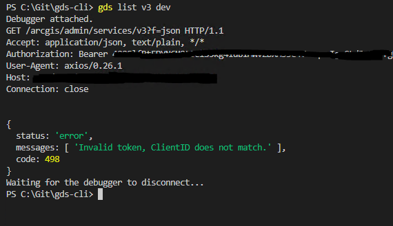

Hello fellow GIS Devs! I've been building out a command line interface to help with some of my administrative tasks using ArcGIS Server 10.7.1 (NOT PORTAL just the standalone server) using node.js, as we plan on upgrading our system to Portal in the future. Because I am not using Portal, I believe the Oath2 workflows will not necessarily work for me. Now to my problem: for some reason in when using Node.js I run into an error regarding the clientID:
  status: 'error',
  messages: [ 'Invalid token, ClientID does not match.' ],
  code: 498
I am using Axios to connect to the administration endpoint and using an interceptor to set the token as an Authorization header for the requests. I have verified the successful return of my token along with it being applied to the GET request at the <myarcserver>/arcgis/admin/services/<folder> endpoint. And yet, I still get the error above which appears to be an Oath2.0 error. Below is a snippet of my instance module along with the module calling it. Please don't make fun of me, I'm just starting to learn Node 😄

And a screenshot of the response:

So what's the difference here? Am I just a node amateur? Why is the admin services directory requesting a client ID when using one language, but not the other?
