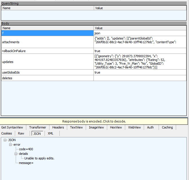

When trying this with Python, I use Fiddler to watch my request to make sure they are correctly formatted and the screenshot below shows the other parameters I'm using but the attachments parameter does not show up all the way because Fiddler truncates the value which is massive in this case due to the base64 encoded image:
the updates call does work when I do not try to add the attachments parameter.  Has anyone had success using the attachments parameter in apply edits?  I know I can add/update/delete attachments one at a time, but it would be nice how to figure out how to batch edit attachments in the applyEdits method.

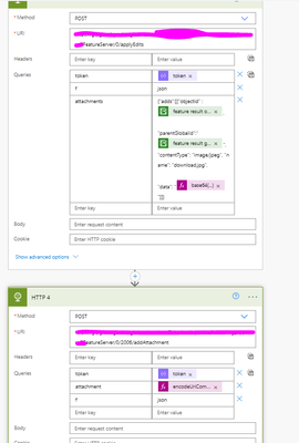

I am trying applyEdits and addAttahcment and i cant get either to go. I'm getting my image from a GET http request. I then tried passing the body of the GET request as the attachment/data. I tried base64 and encodeURI and still nothing works.
Any idea?
