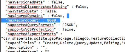

I followed another post https://support.esri.com/en/technical-article/000012383 to change the maxRecordCount to 8000. Even so, I still get only 2000 rows from my export json file.

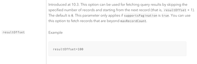

I have never been able to increase the maxRecordCount above 2000, but you have two options:
1) Use the "resultOffset" parameter (which is the pagination mechanism): <- this is the one I would recommend

Came across this limitation myself and found this thread.  Used @Raul_Jimenez 's reccomendation and used the resultOffset parameter in an ArcPy script.  Here is the code if anyone else needs to do something similar.
