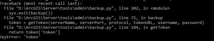

I am trying to schedule a backup of the REST services.
So, I am running the script with Admin credentials on CMD window:
C:\Python27\ArcGIS10.8\python.exe "D:\ArcGIS\Server\tools\admin\backup.py" -u XXXX -p XXXXX -s https://XXXXX/rest/services -f "D:\GIS_Data\backup
but I get this error
I double checked the credentials and the server url and are correct.

Is this a standalone ArcGIS Server or part of a Portal?
Did you ever try this script in an earlier version of ArcGIS?
LefterisKoumis
Standalone.
No, this the first time I am trying this script from:
https://enterprise.arcgis.com/en/server/latest/administer/windows/backup-utility.htm
