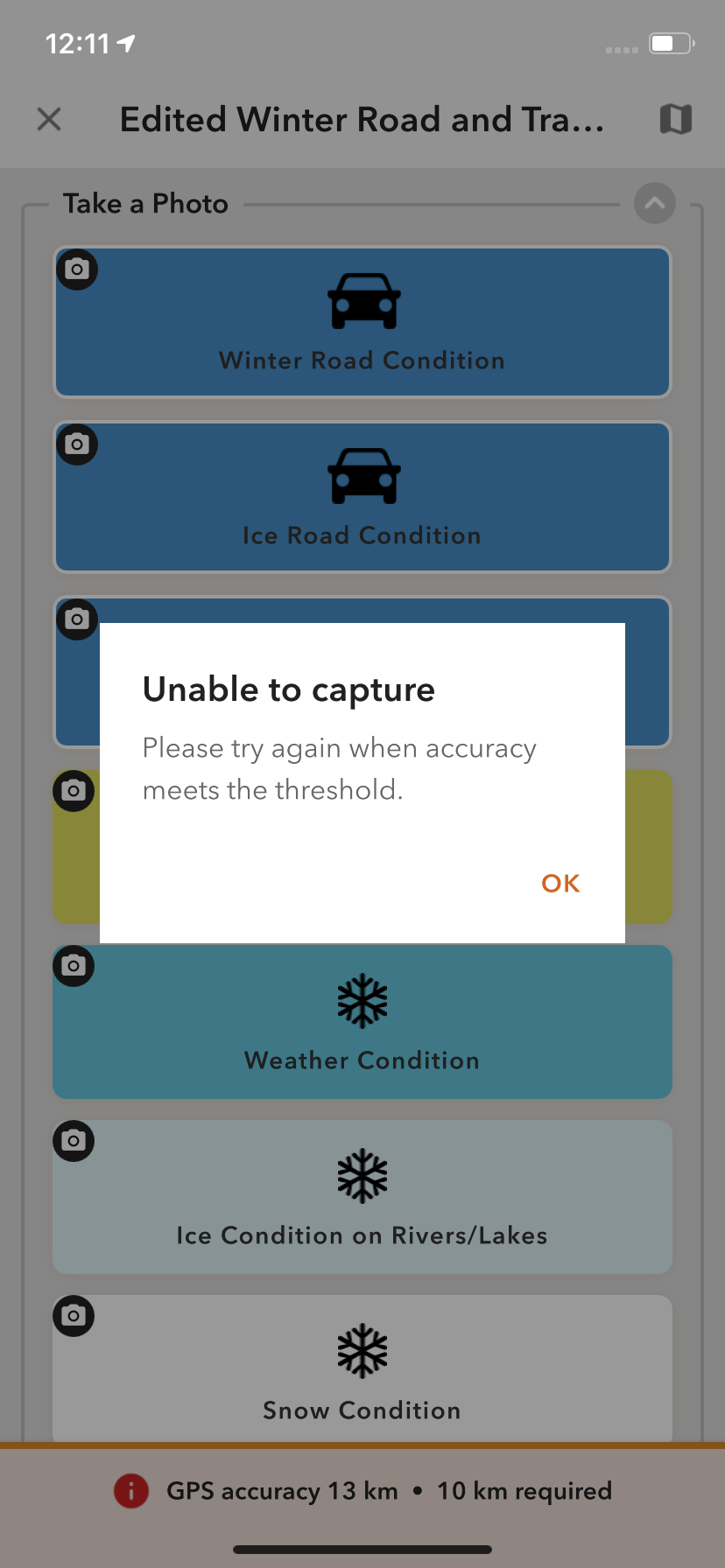

I tested out my QuickCapture app on my mobile phone last week at a rural location in Canada, and the GPS accuracy was 13km. To record location data, the required GPS accuracy is 10km, has anyone else had the same problem? Is there a way to increase the signal or get rid of the required GPS accuracy limit?
I thought GPS is supposed to work anywhere on this planet, or is that simply not true in more rural places? I am planning to use this app in the Northern territories of Canada.

- You can set the required horizontal accuracy in the project (under general settings), this is defined by the project author. Are you able to verify what the horizontal accuracy thresholds (recomended and required) are set to?
- It is strange that both the reported and required accuracy in the screen shot are showing KMs. These are very big numbers and are not expected for a typical phone. I'm wondering if something else is going on.

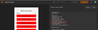

Thanks for this. In the designer can you open the project JSON and confirm the  "horizontalAccuracyError" and "horizontalAccuracyWarning" values are set at?
HaowenRui
Hello Johnathan, Thank you for your reply, I haven't changed anything in this JSON file, and here are the specs:
Is it going to eliminate the GPS accuracy warning if I just change both these numbers to a very high number?
Thanks in advance.
