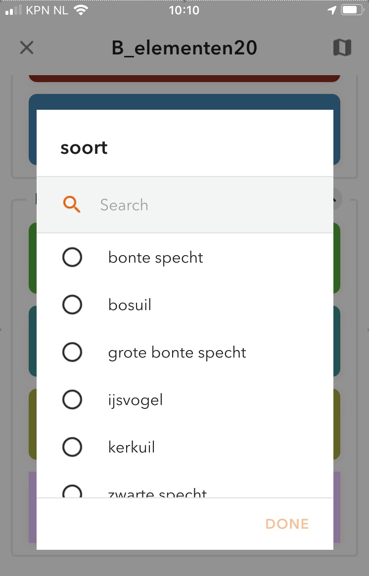

My QC solution has 9 buttons most of which need a required response in which user chooses from a dropdown populated by a coded value domain:
This works! Great!
But when a user unwillingly touches a button they get this dropdown and are obliged to enter something.
I would like to know how to back down from this, after I touched the wrong button, without submitting a record or without closing the app altogether.
Is is possible to 'unclick' the dropdown?
Thanks in advance for your time.
Bert

Hi @Gisbert61 Thanks for your feedback, the product team is currently actively working on this requirement (cancel button user input dialog before adding a record), and it will be available around Q3/Q4 this year.
For now, if a button user input dialog is triggered, you'll have to proceed with the workflow and capture a record. However, you can remove/undo this captured record from the bottom bar of the app. By default, the undo threshold is 6 seconds. If you wish to make it longer, you can go to the QuickCapture project JSON Editor, look for the "undoThreshold" property, modify its value, and save the project.

This is live in 1.10.190
