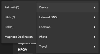

JohnathanHasthorpe
You could also use the device pitch variable and capture continous points. You would leave your phone horizontal in the car, and each captured point would have a pitch value (0 to 45 degress +/-) written to the assigned field. At the same time you could capture the road as continuous line.
https://doc.arcgis.com/en/quickcapture/help/editproject.htm#ESRI_SECTION1_623F8C96724944728C33991B95...
Ideally you would test the reported values for the device you are using, to make sure that these look sensible - as the sensors in different devices may or may not be as reliable.
AdrianWelsh
MVP Honored Contributor
Jonathan, this is intriguing. I might have to check this out as it could be a sort of solution (however, the survey folks might not like this level of 'accuracy'). But my initial thoughts would be, how would I be able to initially put my device/phone on a flat, 0 degree, surface. I suppose a level could help with that. But either way, thanks for the feedback!
