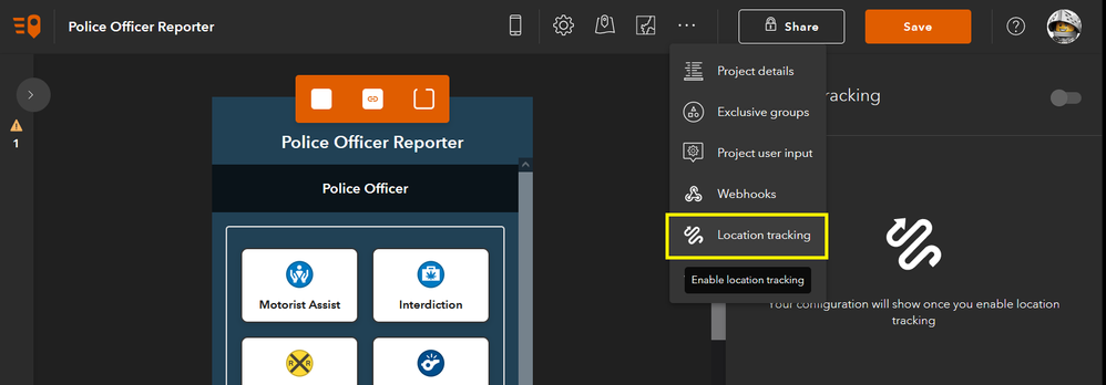

Enabling location tracking in your ArcGIS QuickCapture project

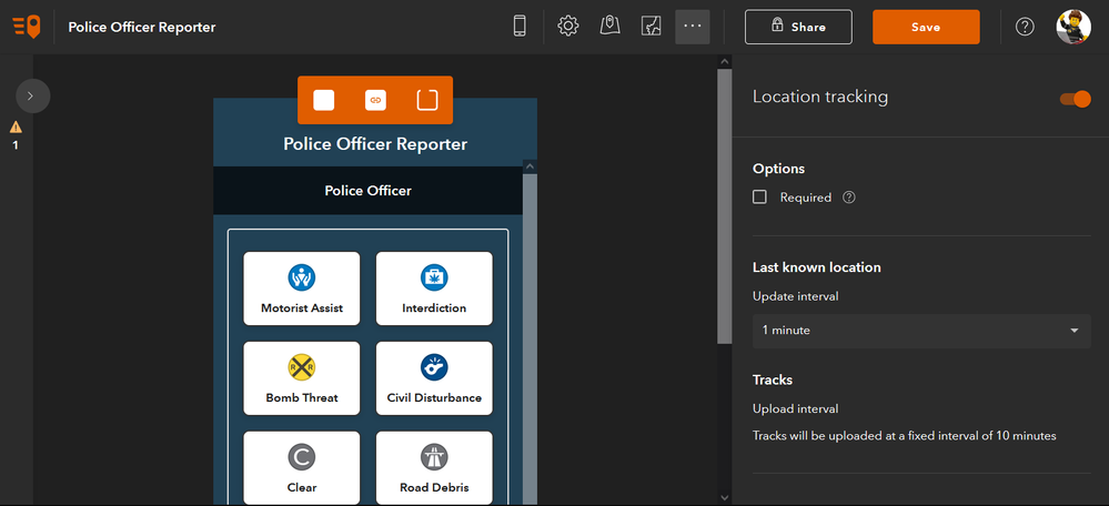

Right from within ArcGIS QuickCapture designer, you will see a new Location Tracking settings option. Use it to activate and manage location tracking within your project.
You can choose to configure location tracking as an optional or required feature:
  • Required: Users will be tracked as  long as they keep the QuickCapture project open. If you want your users to always be tracked, this is the best choice.
  • Not required: End users will decide when they want to be tracked.
By default, the QuickCapture mobile app sends the last known location of the user to ArcGIS every minute, but you can change it to 15 minutes or 1 hour.

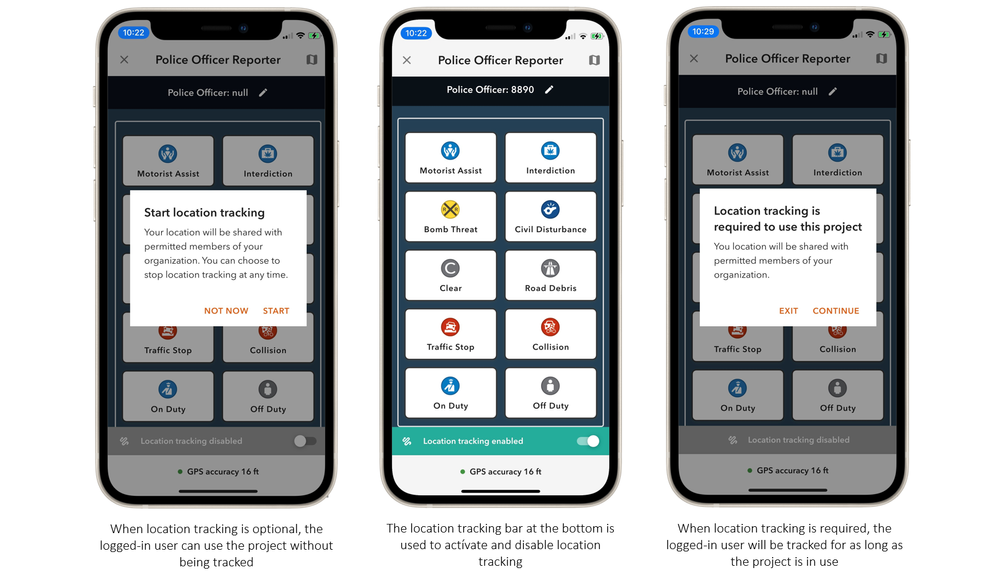

Location tracking in the QuickCapture mobile app
The way users interact with location tracking from the mobile app depends on how the author configures the project:
  • If the QuickCapture project is not configured with location tracking, the end user will not see options to work with location tracking. Even if location tracking is enabled in the organization.
  • When location tracking is enabled, a green bar at the bottom of the project will display the location tracking status.

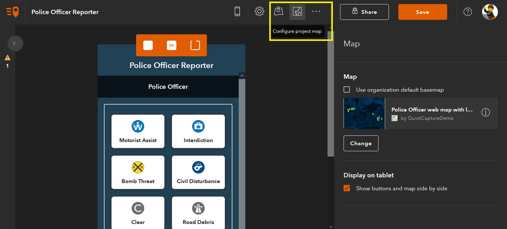

By default, location tracking information is not shown to users in the mobile app. However, if you need mobile users to see the last known location or tracks of their colleagues, you can change that.  For situational awareness, field workers may need to know where other field crews are. To avoid duplication of work, you may want to share tracks from other members of the team.
First, author a web map. Ask the ArcGIS administrator to create a location tracking view* and add it to your web map.  You can also add extra layers of information if you like.  Click on the Configure project map button in QuickCapture designer.  Change your QuickCapture project web map so it points to yours. Save the project, and you are done!
Note: Location tracking views are special. They need to be created by an administrator and users with access to view the data must be granted special privileges. More info here.
