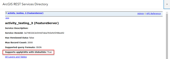

    • Scroll down to the URL section for the feature layer and click the View button.
  • This will open the ArcGIS REST Services Directory page for the feature service. Look for the SupportsApplyEditsWithGlobalIds property and ensure it is set to True.

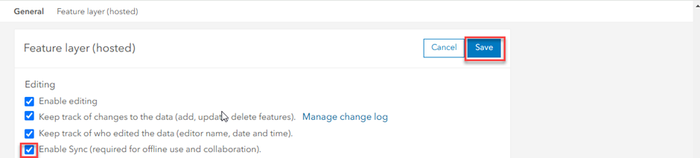

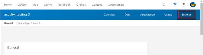

  • If the property is not set to true, go back to the feature layer’s item page and click the Settings tab.
  • Scroll to the Editing section, check the Enable Sync option, and save the change. This will create the required fields and indexes, and set SupportsApplyEditsWithGlobalIds = true.
  • Note: This is a one-way process; you can uncheck Enable Sync later if it is not necessary for your workflows.

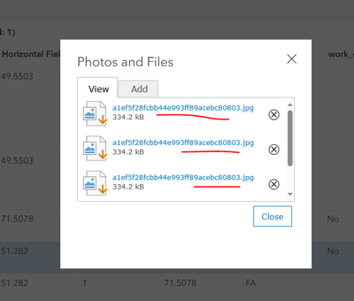

2. Randomly, a record in QuickCapture can have multiple identical attached photos. (same name, same filesize)
Have you or anyone had these issues?
