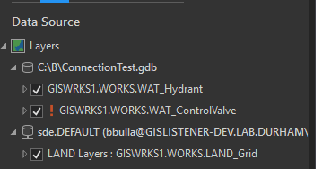

BrianBulla
Honored Contributor
Hi Wolfgang,
I am also using a FileGeodatabase.
When I debug it gets past the first layer, which is "Connected", but on the second layer (the one with the missing data source), I get the exception below thrown.
With mine, I am editing the name of the FeatureClass, not changing the folder name the FGDB sits in.  Not sure if that would be the difference??

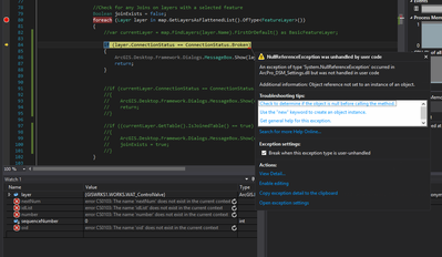

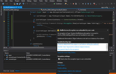

BrianBulla
Honored Contributor
Hi Wolf,
No, there is nowhere in my code where I am doing anything with the object.  I have been messing around, checking for the broken layer in different way, but I always get a NullReference error.
Since I also need to check for joined tablets, I am using the BasicFeatureLayer object which also uses .ConnectionStatus, but still the same problem.
Can you post your code you are using and I will try that??  Here is mine below, all running in a QueuedTask.  The error happens right at the start of the first If statement.
foreach (Layer layer in map.GetLayersAsFlattenedList().OfType<FeatureLayer>())
                        var currentLayer = map.FindLayers(layer.Name).FirstOrDefault() as BasicFeatureLayer;
                        if (currentLayer.ConnectionStatus == ConnectionStatus.Broken)
                        {    //THE ERROR HAPPENS HERE!!!!!
                            ArcGIS.Desktop.Framework.Dialogs.MessageBox.Show(currentLayer.Name.ToString() + " has a missing data source.  Please remove or fix this layer before continuing.", "Missing Data Source");
                            return;
                        if ((currentLayer.GetTable().IsJoinedTable() == true) && (currentLayer.SelectionCount > 0))
                            ArcGIS.Desktop.Framework.Dialogs.MessageBox.Show(currentLayer.Name.ToString() + " has a joined table.  Please remove any joins before continuing.", "Joined table detected");
                            joinExists = true;
In Debug mode it seems like the values are getting read properly, yet I still get the NullReference exception.

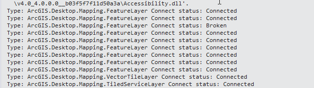

Wolf
by Esri Regular Contributor
Hi Brian,
 Below is my test code.  I am not running within QueuedTask.Run, but i will try that shortly.   Strangely enough i got the exception once as well, but i was not able to duplicate the error after that.  i am still investigating that issue.  The code snippet is taken from the OnClick of a button i added to my test add-in.
protected override void OnClick()
try
		var map = MapView.Active.Map;
				//var currentLayer = map.FindLayers(layer.Name).FirstOrDefault() as BasicFeatureLayer;
				var currentLayer = layer as BasicFeatureLayer;
				System.Diagnostics.Debug.WriteLine($@"Name: {currentLayer.Name} Type: {currentLayer.GetType()} Connect status: {currentLayer.ConnectionStatus}");
catch (Exception ex)
		MessageBox.Show($@"Exception: {ex}");
BrianBulla
Honored Contributor
Hi Wolf,
When using your code, on a button with only that code on it, it works as expected and I see the 'Broken' status in the debug window.
If I take your code and plug it into mine, which is also the click event of a button, I still get the NullReference error.  I'll paste all of my code below, but it must be something in my code that is the problem....I'm just not really sure what, or why.
