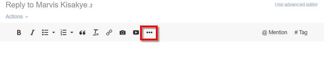

This works beautifully. Thanks! By the way, what setting do you use to get your code snippet to be formatted? I tested all the available options to no avail.
Wolf
by Esri Regular Contributor
I have problems with this feature too.  It doesn't work for me when I reply through the Notification list in my geonet inbox (this might be fixed by now ... I haven't tried it in years), but I get it to work once I navigate to the geonet question link (by clicking on the geonet question).  From the geonet question link, you click "Reply" and then you click on the "..." menu in you reply edit menu bar,
that opens up more options.  Next you click the "More" pull-down and choose syntax highlighter.
In the syntax highlighter popup choose the format from the pull down and paste the text.  The text will be highlighted to make code and xml more readable.  you can also use Ctrl+V to paste an image from your clipboard.
