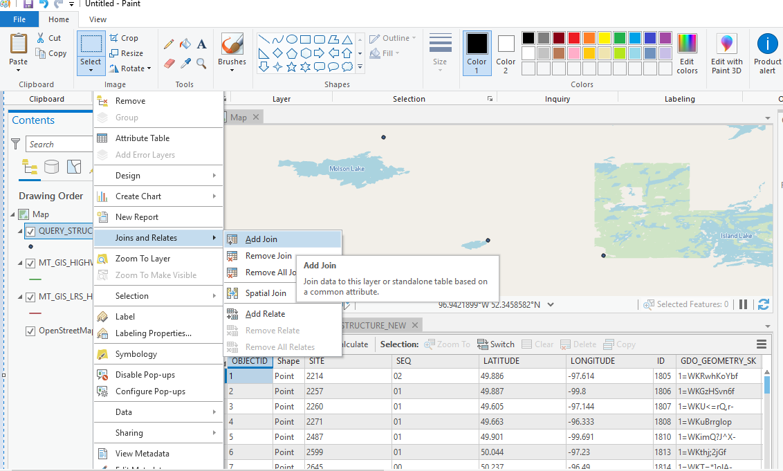

Hi,
Below code works if my Featureclass is not joined with any other Table.
If I add a join to other Table, then it throws an "DataSet does not have a valid definition" expection in featureClass.GetDefinition() line.
I believe it is not able to get the FeatureClassdefinition when it is joined with other table.
If it is not joined then it can get the FeatureClassDefinition and no problem in adding a new record.
Does anyone else have this scenario??  Can you please let me know how to resolve this??

JustinHawley2
Yeah i'm also having the same problem.  Found anything out yet?
